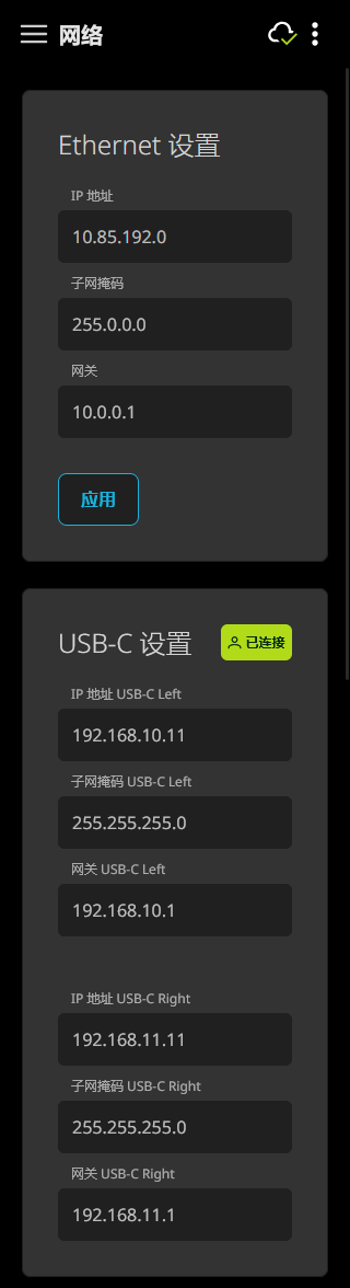

▪Change the network settings of the controller, incl. IP address, under menu »Network
