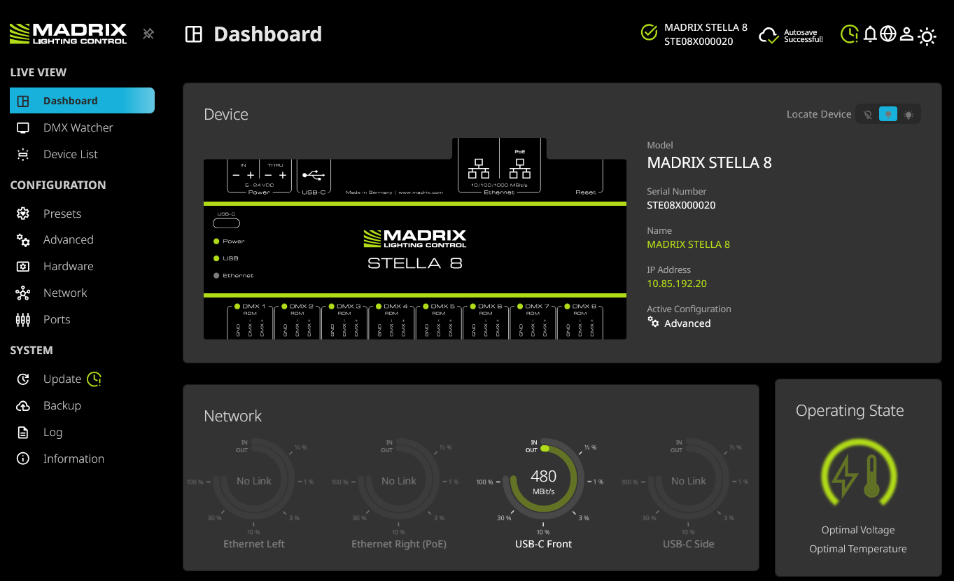

If your web browser and computer are online, they can automatically check if an online update is available and will notify you accordingly by showing the online-update icon in both, the top menu and the left menu:

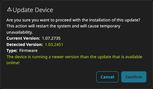

▪A confirmation dialog will be shown.
▪Cancel - Aborts the process or exits the dialog if no newer update is available.
▪Confirm - Proceeds to update the device if a newer version is available online.
This button is disabled if the update has not yet been fully downloaded. A message is shown in this case and downloading takes longer than expected due to a slow internet connection.

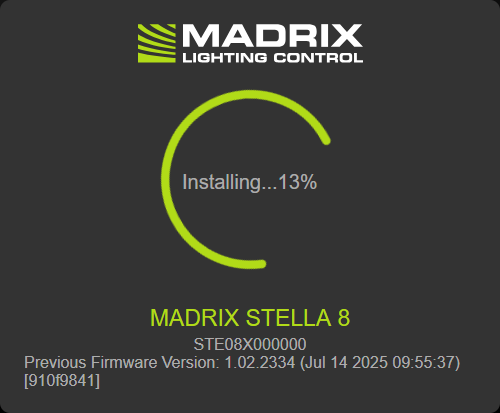

▪A new window opens and shows the installation progress:
- Firmware Updates: The status LEDs of the Ports are blinking green from right to left during the upload and installation process.
- Bootloader Updates: The status LEDs of the Ports are blinking yellow from right to left during the upload and installation process.

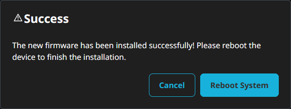

▪Afterwards, the device will automatically disconnect and reconnect. A new window will open:
▪Confirm with Reboot System

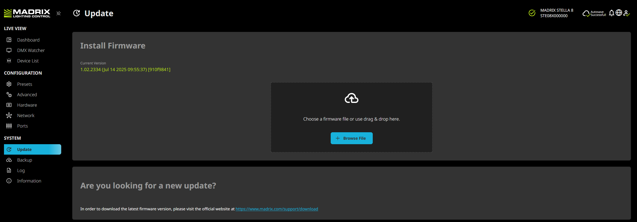

Browse File
Click to choose the firmware file to upload.
▪Supported file formats are *.fwx [Firmware or Bootloader] as well as *.ebin [Firmware] and *.ubin [Bootloader].
▪New firmware files can be downloaded from https://www.madrix.com/support/download
Alternatively, use drag and drop with your mouse to place the firmware file directly on the field.
▪Make sure to upload the correct file!
▪Create Backup - It is recommended to have a backup of the controller's current settings before proceeding.
Click to create and download a backup file now.
▪Install Firmware - Confirm in order to proceed.
