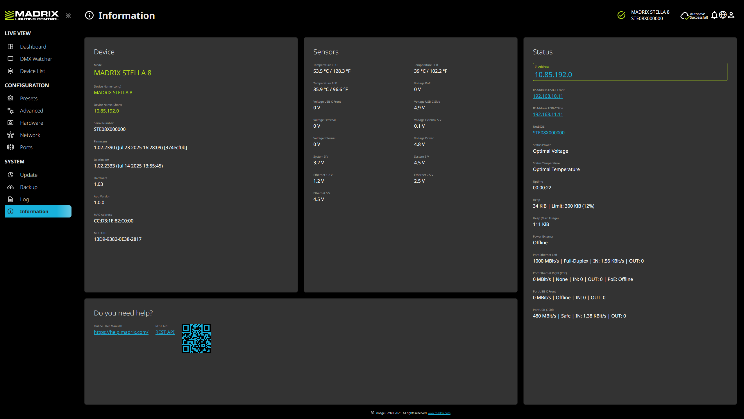

Device
Shows general information about the controller.
Model
Shows the device type: MADRIX STELLA 8.
Device Name (Long)
Shows the Art-Net Long Name; as set under menu »Hardware
Device Name (Short)
Shows the Art-Net Short Name; as set under menu »Hardware
Serial Number
Shows the unique production identifier.
Firmware
Shows the current firmware version, i.e. the customized software that runs on the controller.
Bootloader
Shows the current bootloader version, i.e. underlying software system that runs on the controller.
Hardware
Shows the hardware revision.
App Version
Shows the version number of the Web Panel.
MAC Address
Shows a permanent, unique address of the controller for network communication.
MCU UID
Shows a permanent, unique identifier of the controller for its hardware components.
Product UUID
Shows a permanent, unique identifier for the product type for identification.
Production Date
Shows the time and date when production of the unit was finalized.
Sensors
These values of internal sensors of the controller can also be provided over ArtRdm. See »Using RDM And MADRIX RADAR
Values on this page are constantly being updated for you every 3 seconds.
These values might be requested by the MADRIX support team in case of support inquiries.
Temperature CPU
Shows the current temperature of the main processor [in °C and ° F].
Temperature PCB
Shows the current temperature of the electrical circuit board [in °C and ° F].
Temperature PoE
Shows the current temperature of components regarding Power over Ethernet [in °C and ° F].
Voltage PoE
Shows the voltage currently provided by Power over Ethernet [in V].
Voltage USB-C Front
Shows the voltage currently provided by USB-C Front [in V].
Voltage USB-C Side
Shows the voltage currently provided by USB-C Side [in V].
Voltage External
Shows the voltage currently provided when connecting through a Power port [in V].
Voltage External 5 V
Shows the 5-V-voltage-marker currently provided when connecting through a Power port [in V].
Voltage Internal
Shows an internal-voltage marker [in V].
Voltage Driver
System 3 V
Shows the 3-V-systems-voltage marker [in V].
System 5 V
Shows the 5-V-systems-voltage marker [in V].
Ethernet 1.2 V
Shows the 1.2-V-Ethernet-voltage marker [in V].
Ethernet 2.5 V
Shows the 2.5-V-Ethernet-voltage marker [in V].
Ethernet 5 V
Shows the 5-V-Ethernet-voltage marker [in V].
Status
Shows specific information of the status of the controller, especially regarding power and communication.
Shows the IP address [and connection type] that is currently being used for the communication to access the web panel of the controller.
IP Address
Shows the current IP address regarding Ethernet network.
Can be used as a click-able link to call the controller with this IP address in the web browser.
Is shown with a green outline if currently used to access the web panel.
IP Address USB-C Front
Shows the fixed IP address of USB-C Front.
IP Address USB-C Side
Shows the fixed IP address of USB-C Side.
NetBIOS
Is an alternate way to call up the web panel or find the controller in the network, and without using the IP address.
Can also be used as a click-able link to call the controller with its NetBIOS name.
[Main workflow: Assuming correct network settings, simply type http://SERIALNUMBER/ into your web browser, such as http://STE08X000001/ ; often merely STE08X000001/ should work. If you want to ping the device, use only STE08X000001]
Status Power
Shows the status of the supply of power for the controller [Optimal Voltage, Voltage Too Low, Voltage Too High].
Status Temperature
Shows the status of the ambient temperature for the controller [Optimal Temperature, Temperature Too Low, Temperature Too High].
Uptime
Shows the time that has passed since the last power-cycle or restart.
Heap
Shows an internal indicator of memory load [Current | Limit (Percentage)] [in KiB].
Heap (Max. Usage)
Shows the most heap that has been used so far [in KiB].
Power External
Shows the status of the power connection [Offline [Not Connected], Safe [Successfully Connected], Collapsed [Not Connected Anymore], Insufficient [Connected But Not Enough Power], Voltage Too High [Overvoltage]].
Port Ethernet Left
Shows details about the Ethernet Left port, including connection speed [in MBit/s], status [Full-Duplex, Half-Duplex, None Connection], incoming data rate [IN], and outgoing data rate [OUT].
Port Ethernet Right (PoE)
Shows details about the Ethernet Left port, including connection speed [in MBit/s], status [Full-Duplex, Half-Duplex, None Connection], incoming data rate [IN], and outgoing data rate [OUT], Voltage Too High [Overvoltage].
Port USB-C Front
Shows details about the USB-C Front port, including connection speed [in MBit/s], status [Offline [Not Connected], Safe [Successfully Connected], Collapsed [Not Connected Anymore], Insufficient [Connected But Not Enough Power], Voltage Too High [Overvoltage]], incoming data rate [IN], and outgoing data rate [OUT].
Port USB-C Side
Shows details about the USB-C Side port, including connection speed [in MBit/s], status [Offline [Not Connected], Safe [Successfully Connected], Collapsed [Not Connected Anymore], Insufficient [Connected But Not Enough Power], Voltage Too High [Overvoltage]], incoming data rate [IN], and outgoing data rate [OUT].
Browser Name
Shows which web browser is currently being used to access the web panel.
Browser Resolution
Shows with which display resolution the web panel is currently being shown in the web browser.
Help
Online User Manuals
QR Code
Provides a click-able link and a scan-able image to the online help website of MADRIX for user manuals and guides: »help.madrix.com
REST API
Provides a click-able link to the offline help website of functions and commands used by the web panel to communicate with the firmware of the device.
PDF Datasheet
QR Code
Provides a click-able link and a scan-able image to the PDF datasheet of the device:
»https://www.madrix.com/download/mhm/documentation/STELLA8/Datasheet_MADRIX_STELLA_8.pdf
PDF Technical Manual
QR Code
Provides a click-able link and a scan-able image to the PDF technical manual of the device:
»https://www.madrix.com/download/mhm/documentation/STELLA8/Technical_Manual_MADRIX_STELLA_8.pdf
PDF User Manual
QR Code
Provides a click-able link and a scan-able image to the PDF user manual of the device [this user manual here]:
»https://www.madrix.com/download/mhm/documentation/STELLA8/User_Manual_MADRIX_STELLA_8.pdf
Web Release Notes
QR Code
Provides a click-able link and a scan-able image to the release notes of firmware updates in this user manual Firmware Updates
