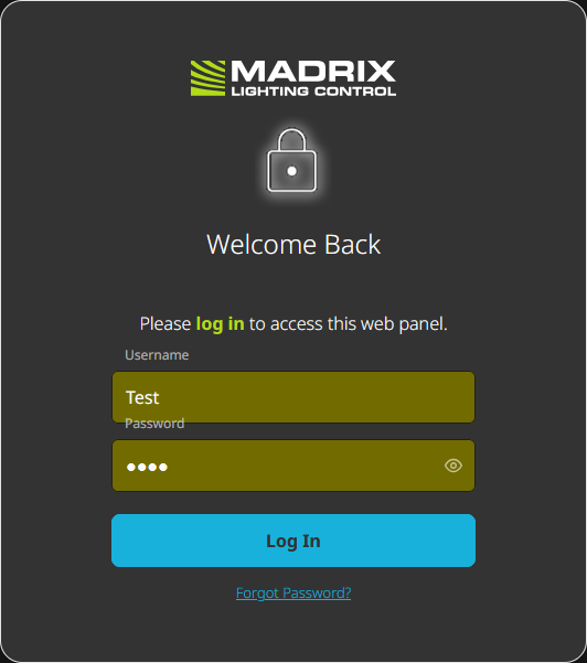

Web Panel Access Control
You can set a Password to restrict access to the web panel of this controller and therefore prevent any changes to its configuration.
Enable Access Control
Allows you to enable or disable the access control.
Once enabled, the following options become available:
Make sure to remember the chosen Username and Password!
Username
Enter a profile name [with a maximum of 31 characters plus null].
Password
Enter a password [with a maximum of 31 characters plus null].
The UTF-8 character set is supported. Special characters might reduce the total possible character count.
Verify Password
Enter your chosen password a second time for verification.
Please enter it the exact same way you entered it the first time!
Confirm any changes with Apply
When successful, you will be asked for your login:
▪Enter your chosen Username
▪Enter your chosen Password
You can show the entered password via the eye symbol.
▪Confirm with Log In
When logged in, the menu will show it accordingly:
Log Out
Locks access to the web panel again by logging you out.
▪You are then forced to log into the web panel again with the set Username and Password before you can access the device and its web panel again.
▪Important: You will automatically be logged out after 30 minutes of inactivity!
Forgot Password?
In case you cannot remember the chosen Username and Password, access to the device can only be restored by performing a Reset To Factory Default Settings. This must be done in person and thus requires personal access to the controller itself.
