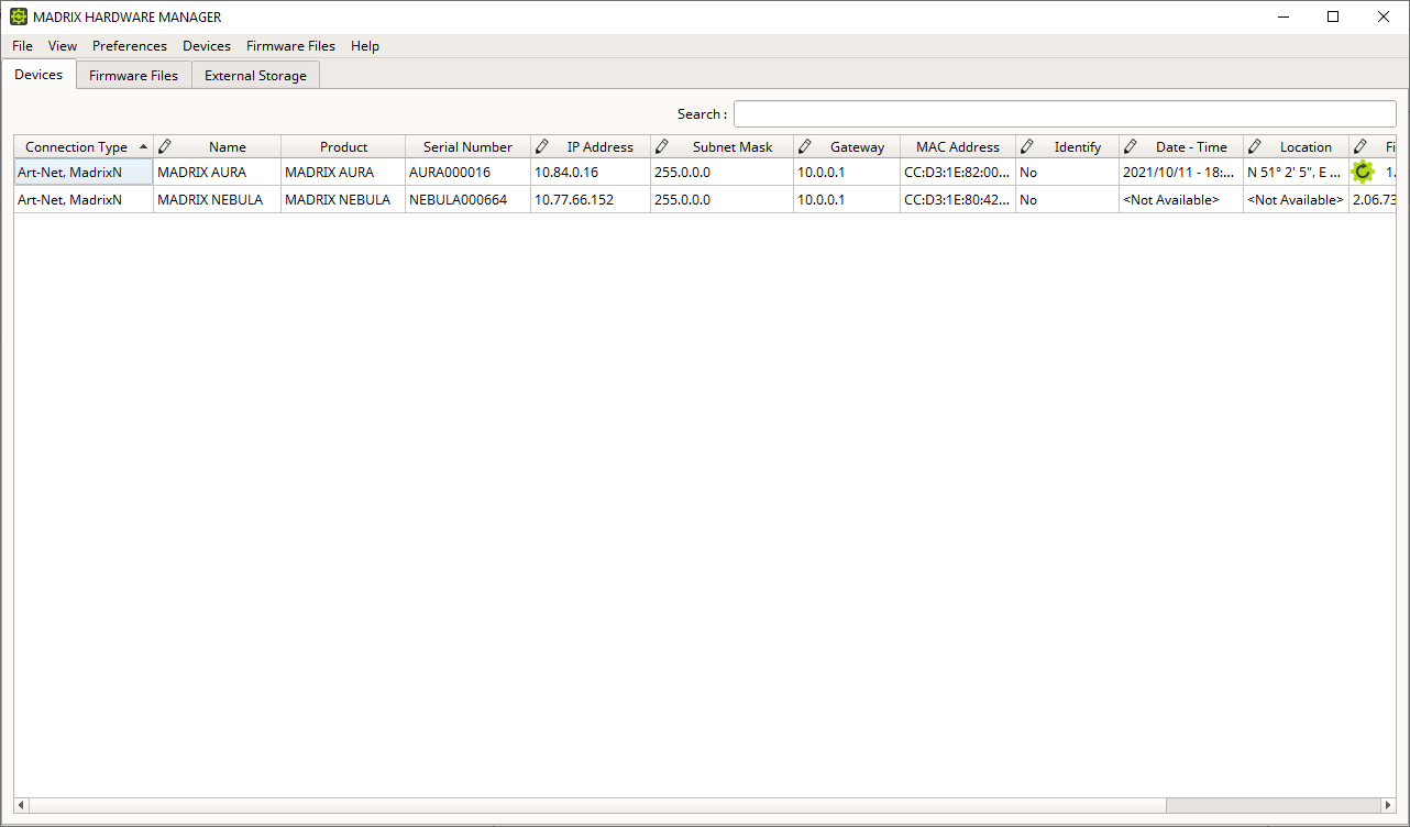

▪1] In MADRIX HARDWARE MANAGER, navigate to the Devices tab.
▪2] You will see connected devices in a list including their current main settings.
▪3] Basic settings can be changed and configured, including Name, IP Address, Subnet Mask, Gateway, and more.

▪1] In MADRIX HARDWARE MANAGER, navigate to the Firmware Files tab and make sure you have the right [the latest] firmware version already downloaded and available. An active internet connection is required.
▪2] Go to the tab Devices and select a device/devices in the list.
▪3] Navigate to the column Firmware and select the firmware you wish to install on the devices.
