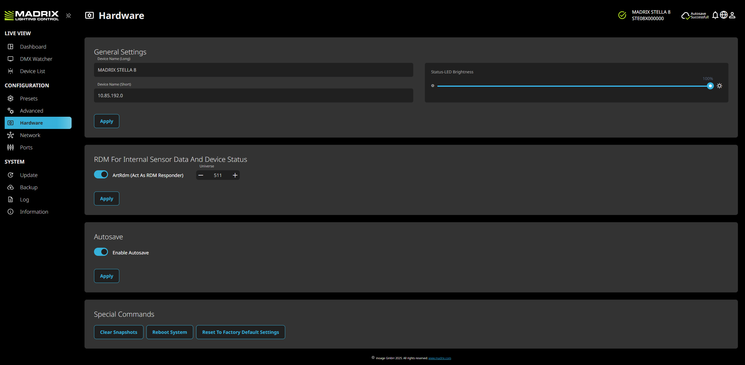

General Settings
Device Name (Long)
This refers to Long Name identifier used by Art-Net [with a maximum of 63 characters plus null].
Also refers to DEVICE_LABEL within the RDM specifications [with a maximum of 31 characters plus null].
The default value is MADRIX STELLA 8.
This identifier is also used as the Web Panel's title in the tab of the web browser.
Device Name (Short)
This refers to Short Name identifier used by Art-Net [with a maximum of 17 characters plus null].
The default value is the IP address of this controller, e.g. 10.85.192.0.
Status-LED Brightness
Sets the maximum brightness level of the controller's physical status LEDs.
Valid values range from 10 % to 100 %.
The default value is 100 %.
Confirm any changes with Apply
RDM For Internal Sensor Data And Device Status
ArtRdm (Act As RDM Responder)
Allows you to enable or disable ArtRdm.
By default, this setting is enabled.
ArtRdm allows the device to be able to reply to RDM requests by an RDM Controller as an RDM Responder over Art-Net with its status and sensor data.
This enables monitoring of the MADRIX STELLA 8 via RDM, such as the MADRIX RADAR Software.
MADRIX STELLA 8 mainly provides data regarding:
▪Various Temperature Values
▪Various Voltage Values
▪Device Model [incl. Hardware Revision]
▪Software Version [of the Firmware and Bootloader]
▪And other device information, such as IP Address, Device Short/Long Name, etc.
▪Learn more »Using RDM And MADRIX RADAR
Universe
Defines the universe on which sensor data is relayed.
Valid values range from 0 to 32767.
The default value is 511. [Which is universe 512 for 1-based indexes.]
Autosave
Enable Autosave
Allows you to enable or disable the automatic saving feature.
This makes sure that settings are automatically saved on the device after making changes in the web panel.
You can also quickly change this setting in the top menu under
Special Commands
Clear Snapshots
Deletes all Snapshots you have created from the controller.
Confirm your choice via Delete or abort the process via Cancel
Learn more under menu »DMX Watcher
Reboot System
Restarts the controller completely.
Confirm your choice via Reboot or abort the process via Cancel
[The website will automatically be reloaded after 30 seconds.]
Reset To Factory Default Settings
Restores the original settings of the controller.
[Snapshots will also be cleared.]
Confirm your choice via Reset Settings or abort the process via Cancel
The MADRIX Logo on the controller will flash repeatedly during the short process.
[Since this will change back the IP address to the original setting, the web panel will automatically be reloaded after a few seconds and you will automatically be redirected to the correct web panel and IP address.]
