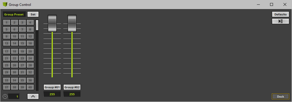

Can be configured in the Group Control to further control fixture groups. Learn more »Fixture Groups [Group Control]
Can only be used to chase fixture group values.

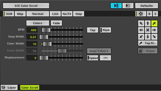

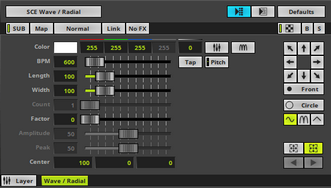

Example
An Effect Parameter Chaser, for example, offers many ways to customize visuals. In this first example, we will use the Effect Parameter Chaser to set 4 different movement directions for SCE Color Scroll within 60 seconds.
Step 1]
For the first 15 seconds, MADRIX 5 should show SCE Color Scroll with the Direction Top Left
Preview
Step 2]
For the next 15 seconds, MADRIX 5 should show SCE Color Scroll with the Direction Top Right
Preview
Step 3]
For the next 15 seconds, MADRIX 5 should show SCE Color Scroll with the Direction Bottom Right
Preview
Step 4]
For the last 15 seconds, MADRIX 5 should show SCE Color Scroll with the Direction Bottom Left
Preview

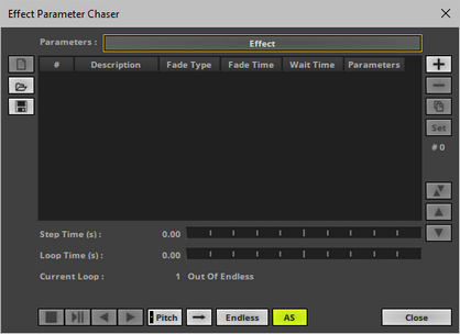

Creating A Chaser
Right Mouse Click on > Edit...
Storage Place Parameter Chaser
Group Value Chaser
1] Select which kind of Parameters to include for a Step.
2] Add Steps.
3] Control the Chaser playback.

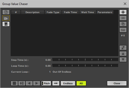

Group Value Chaser
It is not necessary to select any Parameters, since only one set of Parameters can be chased [fixture group values].
2] Adding New Steps Or Editing Steps
A Chaser is represented by a list of Steps in the Chaser window.
- Add and configure or edit Steps as needed.
- A Chaser normally runs through the list in a sequence. The order is defined by the Playback Mode.
 [The direction may also be reversed when using negative values for the Speed Pitch or the Speed Masters. Learn more below.]
- When a loop is set up, the Chaser repeats.
Adding Or Editing Steps
Use the following controls on the right side of the Chaser window:
Add Step - Adds a new Step to the list.
- The newly added Step includes all currently set Parameters [according to your Parameters selection. Learn more Selection Of Parameters].
- A newly added Step will be created with the default values for Fade Time, Fade Type, Wait Time, and Description.
- First, make sure that the visuals look as intended, that all settings are defined as required, and then add the Step.
- Please stop the Chaser if it is currently running.
Remove Steps - Removes all currently selected Steps from the list.
Duplicate Steps - Copies the currently selected Steps and adds them as new Steps to the list.
Set - Updates the Step by overwriting the saved settings in the Step with the current settings.
- Note: Before updating a Step, make sure that your current settings are correctly set. This includes all settings on the user interface as well as the selection of Parameters of the Chaser window. It is therefore highly recommended to 1) first load the Step [if a Fade Time is set up, wait until the Step has fully loaded and stopped], 2) second to change all required settings, and 3) update the Step via Set. Learn more Activating A Step / Loading A Step
Synchronize Parameter Selection - Is only visible when necessary and if a Step is selected. Shows that your current selection of Parameters [learn more Selection Of Parameters] is different to the Parameters of the selected Step [learn more Parameters]. In order to set the selection of Parameters to the Parameters of the Step, click the equal sign.
# 3
Shows the total number of Steps in the Step list. An empty list shows # 0
Swap Position - Swaps the position of Steps in the Step list when several Steps are selected first.
Position Up - Changes the order, and positions currently selected Steps one item higher up in the list.
Position Down - Changes the order, and positions currently selected Steps one items lower down in the list.
Configuring Steps In the Step List
Use the following columns of the Step list:
Shows the index number of this Step in the list.
- This index number cannot be edited in the list.
- But you can change the order of Steps by changing the position of Steps via Swap Position, Position Up, and Position Down
Description
Allows you to provide a label for the specific Step. Perform a left mouse double-click and enter any name or text.
- The default value is Step.
Fade Type
Defines how the Step is faded in, when a Fade Time has been set.
- You can choose from a variety of types [Linear, Ease In Bounce, Ease Out Bounce, Ease In Out Bounce, Ease In Circular, Ease Out Circular, Ease In Out Circular, Ease In Cubic, Ease Out Cubic, Ease In Out Cubic, Ease In Sinusoidal, Ease Out Sinusoidal, Ease In Out Sinusoidal, Ease In Exponential, Ease Out Exponential, Ease In Out Exponential].
- The default value is Linear.
Fade Time
Defines how long the Step is faded in [in s]. Change it to any time. This creates an automatic transition from one Step to another Step.
- When possible a smooth transition is automatically created by gradually increasing or decreasing values for Parameters.
- Certain Parameters can be used for a smooth transition.
- Certain Parameters cannot be used for a smooth transition and will be selected or switched on or off at the beginning of the Fade Time.
- The transition is affected by Fade Type and Fade Time.
- Valid values range from 0.0 to 99999.99.
- The default value is 0.0 [which means that there is no transition/fade-in by default].
- Learn more Fade Time And Animations
Wait Time
Defines how long the Step is shown before skipping to the next Step in the list [in s].
- Is separate from the Fade Time, which means it does not include the Fade Time.
- The default value is 1.0.
Parameters
Shows which Parameters were included for this specific Step.
- This column cannot be edited in the list.
- But you can specify the values by selecting the Parameters before adding a new Step via + or before changing an existing Step via Set
Monitoring The Duration
See the following controls at the bottom of the Chaser window:
Step Time (s)
Shows the duration of the currently selected or currently running Step in seconds as well as graphically as a progress bar.
Loop Time (s)
Shows the duration of the overall loop including all Steps in seconds as well as graphically as a progress bar.
Current Loop
Shows in which loop the Chaser currently is. Only when an overall loop has been completed, the count will be increased.
Managing Chasers
Use the following controls on the left side of the Chaser window:
New - Immediately removes all items from the list.
Open - Loads a previously saved Chaser from an external file [of the file type *.mepcz or *.mepcx for Effect Parameter Chasers; of the file type *.msppcz or *.msppcx for Storage Place Parameter Chasers; of the file type *.mgvcz or *.mgvcx for Group Value Chasers].
- A new window opens for you to select the file on your harddisk.
Save - Saves the Chaser to an external file.
3] Controlling The Chaser Playback
Control the Chaser playback using the following controls at the bottom of the Chaser window:
Stop - Stops the Chaser.
Stopped - Shows that the Chaser has been stopped.
Play/Pause - Starts the Chaser or pauses the playback and remembers the current position.
- Playback will start from the beginning if the Chaser has not been started before or if the playback has been stopped via Stop
- Playback will continue from the current position if the Chaser has been paused.
Playing - Shows that the Chaser is currently running.
Paused - Shows that the Chaser has been paused.
Previous Step - Returns to the previous Step and plays back that Step.
- If the Chaser has not been running, playback will stop after the Fade Time of this Step has passed.
- If the Chaser is running, playback will continue with the following Step automatically.
Next Step - Skips to the following Step and plays back that Step.
Pitch - Defines the overall speed of the Chaser and the Step List. It works as a multiplier/a factor.
Example: A pitch of 2.0 will double the current speed.
Move the fader upwards to increase the speed.
Move the fader downwards to decrease the speed.
The default value is 1.0 [which is normal speed].
A value of 0.0 will stop the Chaser.
The highest value is +10.
The lowest value is -10.
Negative values will reverse the playback direction. When setting a negative pitch during playback, the current Step will be fully played and only after its Step Time is over, the following Step will be chased.
[The playback direction depends on the Playback Mode.]
Right-click on the Pitch button to reset to the value of 1.0
The tooltip shows the currently set value.
Playback Mode - Defines in which order Steps are played back. This only affects the order in the Step List, not the playback direction of a Step itself.
- Forward - Steps will be played back in the order of the Step List.
- Backward - Steps will be played back as configured in the Step List but backwards.
- Ping Pong - Steps will be played from top to bottom in the Step List and then from bottom to top again. The first and last Step will be played only once every time.
- Random - Steps will be chosen randomly and only once during a single loop. The random order remains when pausing playback. Only when stopping the Chaser, the order will be randomly created again.
Loop Count - Defines how often the Chaser is being played.
- Endless - The Chaser will always run until you manually stop or pause it.
- 1x - The Chaser will run once and automatically stop at the end of the last Step.
- 2x to 100x - The Chaser will run multiple times as indicated by the loop number.
Autostart - Starts the Chaser automatically again when switching back to the Storage Place or Group Preset.
Left Mouse Double-Click - Perform a double-click with your left mouse button directly on the index number of a Step [as shown in the column # of the Step list].
- Activating a Step is possible at any time when the Chaser is running. Playback will automatically continue with the following Step.
- Loading a Step and therefore loading its settings is recommended before updating the Step via Set. Stop or pause the Chaser first. Playback will stop at the end of the Step if the Chaser has been stopped or paused. Learn more Set
Resizing The Window
You can resize the window according to your needs by dragging the window borders outwards or inwards.
Closing The Window
Close - Closes the window.
