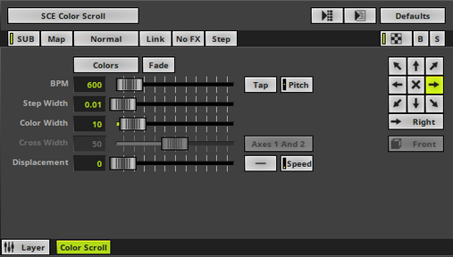

SCE Color Scroll displays various, moving colors. This MADRIX Effect is extremely versatile.
Various buttons and controls have universal functions. They are available for each MADRIX Effect / Layer.
This MADRIX Effect uses the following, individual controls:
Colors - Opens the Color Table to specify the colors. The default colors are Red, Yellow, Green, Cyan, Blue, Magenta.
Learn more »Using Colors And Intensity
BPM - Defines the speed. The default value is 600. Valid values range from 0 to 9999.
Learn more »Using BPM Control
Step Width - Defines the number of pixels the effect should scroll/skip in the direction per frame [in % of the Matrix Size]. The default value is 0.01. Valid values range from 0.01 to 100.
Color Width - Defines the width of a single color [in % of the Matrix Size]. The default value is 10. Valid values range from 0.01 to 100.
Cross Width - Is only available for Cross Mode [»Using Directions]. Defines the size of crossing colors [in %]. The default value is 50. Valid values range from 0.01 to 100.
Displacement - Defines the amount of distortion. The default value is 0. Valid values range from 0 to 100.
Cross Mode Axes - Is only available for Cross Mode. Allows you to choose to which axis Cross Mode applies [Axes 1 And 2, Axis 1, or Axis 2]. The default setting is Axes 1 And 2.
Displacement Distribution - Is only available for Displacement. Is applied in dependence of the direction that is chosen. Allows you to choose the area the distortion is applied to [Uniform, Linear Increasing, Linear Decreasing, Triangle]. The default setting is Uniform.
Displacement Speed - Is only available for Displacement. Allows you to choose to speed in which the distortion affects the visuals. The default setting is 10.0.
Direction/Mode - Allows you to choose the direction of the movement, including Cross Mode. This includes all directions for 2D and 3D mode. This heavily influences the visual outcome of the effect. The default setting is Right. Learn more »Using Directions
Look-At Type - Allows you to choose from which side you want to look at the effect. This is mainly relevant for 3D. The default setting is Front. Learn more »Using Directions
