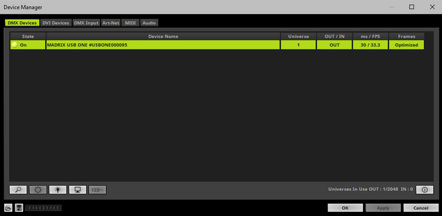

2] Activating Devices [State]
Go to the menu Preferences > Device Manager ...> DMX Devices
[Keyboard shortcut: F4]
The tab DMX Devices will be selected automatically.
Click
[Keyboard shortcut: F5]
- MADRIX 5 disconnects all DMX512, Art-Net, and other devices and starts to search for new or newly connected devices.
- Do not rescan for devices if all of your interfaces have been found correctly.
Make sure that one or more devices are selected.
Right Mouse Click on the column State to set from Off to On [indicated by green light].
[Alternatively, you can perform a Left Mouse Double-Click]
3] Output or Input [OUT / IN]
A] Right Mouse Click on the column OUT / IN to set to OUT for data output.

4] DMX Universe [Universe]
When using your device as an output device, set up Universe
- Right Mouse Click or Left Mouse Double-Click on the column Universe and enter the required number.
This setting assigns a specific DMX universe [of the Patch] to the device or the port of the device. Learn more »Virtual DMX Universes
Make sure to assign the correct universe according to your requirements.

5] Frame Time [ms / FPS]
Set up the frame time for your device.
- Right Mouse Click or Left Mouse Double-Click on the column ms / FPS and enter the required number.
- The frame time [in milliseconds; ms] affects the frame rate. The frame rate specifies how fast data is sent to the device or received from it [in Frames Per Second; FPS].
- Increase the frame time in order to decrease the frame rate [e.g., 40 ms = 25 FPS].
- Decrease the frame time in order to increase the frame rate [e.g., 20 ms = 50 FPS].
- The default value is 30 ms / 33.3 FPS.
- The minimum value that can be set is 1000 ms / 1 FPS
- The maximum value that can be set is 5 ms / 200 FPS.

7] Optimized Frames Or Full Frames [Frames]
Choose how to send data.
- Right Mouse Click or Left Mouse Double-Click on the column Frames to choose between Optimized and Full
- Per DMX512 standard, MADRIX 5 only sends the number of DMX channels that is configured [optimized frames]. For example, if you are using 312 DMX channels on a DMX universe, only 312 DMX channels will be sent with every single frame on this universe.
- Activate Full Frames if devices should always send full frames on a particular universe, instead of optimized frames. Sending full frames means that always the full 512 DMX channels of a DMX universe will be sent with every frame [even when you are using less than 512 channels on the universe].
- Activating Full Frames is recommended if problems with the data output of your devices occur.
