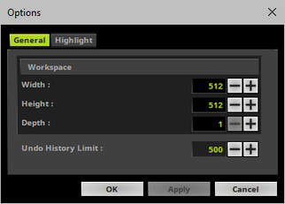

Workspace The workspace allows you to freely position fixtures and work with them on a grid. ▪If needed, change the size of the workspace according to your needs by adjusting Width, Height, and Depth ▪MADRIX 5 will automatically increase the size of the workspace if you are adding fixtures to positions that are outside of the current workspace size. Note: The workspace is the large grid you are working on. In contrast, the virtual LED matrix [i.e., Matrix Settings] tells MADRIX 5 the total size of the fixtures and of the LED installation.
Undo And Redo You can use Undo and Redo to revert actions while working in the Patch Editor. ▪If needed, change this so-called Undo History Limit according to your needs.

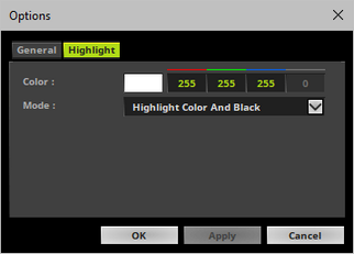

Highlight
Highlight Options allow you to change how the built-in Highlight mode for fixtures work [menu Preferences > Highlight Selected Fixtures]. ▪Highlight Color - Defines the color that is sent to highlighted fixtures. The default color is white. ▪Lowlight Color - Defines the color that is sent to all other fixtures that are currently not highlighted. The default color is black. ▪Mode - Defines how the highlight mode works. Select from 2 options:

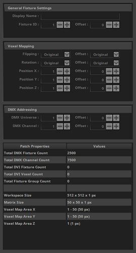

The Patch Editor can provide a useful overview over the most important settings, such as Matrix Size and Workspace. The overview is provided in the lower right corner. First, make sure that no fixture is selected!
▪Patch Properties - The following information is available to you:

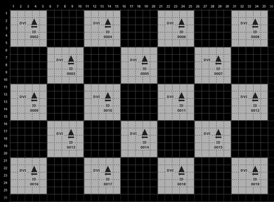

Copying DVI Fixtures Single DVI Fixtures ▪Select a single DVI fixture while holding Ctrl. Then, continue to hold Ctrl and the left mouse button and drag your mouse and a copy of the DVI fixture will be created. Simply release the mouse at the fixture's new position. Multiple DVI Fixtures ▪Select multiple DVI fixtures while holding Ctrl. Now hold down the left mouse button at the same time on any of the selected fixtures. Drag your mouse and copies of the DVI fixtures in a corresponding pattern will be created. Simply release the mouse at the fixtures' new position.

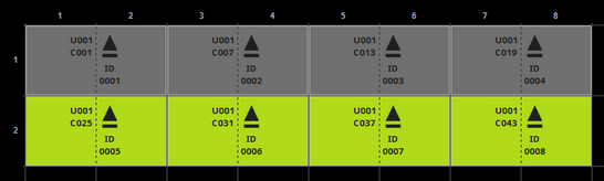

Copying DMX Fixtures [Auto Addressing] Overview Pay attention when using auto addressing and double-check if each fixture is addressed correctly!
▪Copying DMX fixtures has been improved by adding auto addressing. ▪If auto addressing is enabled, MADRIX 5 will automatically increase the DMX channel [and DMX universe] of the copied fixture. ▪In the Patch Editor, go to Preferences > Automatically Address New DMX Fixtures to activate auto addressing. ▪Disable this feature and the copied fixtures will have the same DMX channel and universe as their sources.
Single Fixtures ▪Select a single DMX fixture while holding Ctrl. Then, continue to hold Ctrl and the left mouse button and drag your mouse and a copy of the DMX fixture will be created. Simply release the mouse at the fixture's new position. ▪The DMX channel and the DMX universe will be automatically adjusted if auto addressing is enabled. ▪Example: The original fixture at position 1,1 is patched to DMX universe 1 and channel 1. It requires 3 DMX channels. Therefore the first copy, fixture number 2, is automatically set to channel 4, and so on.
Multiple Fixtures ▪If you select several DMX fixtures, auto addressing also works. The intelligent function calculates the next free DMX address for each of the copied DMX fixtures and automatically adjusts the DMX channel and the DMX universe for each fixture. ▪Example 1: A row of four linearly addressed fixtures shall be copied at once [6 DMX channels per fixture]. Result: Each fixture will be addressed to the next free DMX address in comparison to the previous fixture.

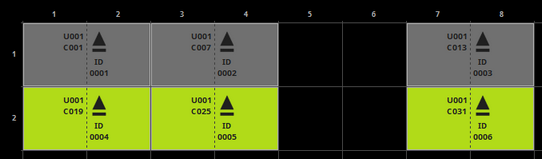

▪Example 2: A row of four linearly addressed fixtures shall be copied at once, while fixture number 3 has a higher address than fixture number 4 [6 DMX channels per fixture]. Result: Fixture number 7 has also a higher DMX address than fixture number 8.
▪Example 3: A row of three linearly addressed fixtures should be copied at once, while spacing and an offset is added to fixture number 3 [6 DMX channels per fixture]. Result: Fixture number 6 continues with the next free addressing of fixture number 5 and does not have an additional offset, while keeping the spacing.

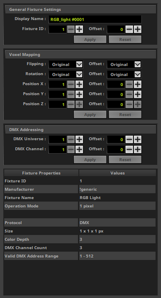

The following workflows are mainly relevant for the view mode Voxel Map, but can also work selectively in the DMX Map. Overview ▪In order to configure a fixture in the Patch Editor, select it first. ▪The corresponding information will be displayed in the third column. ▪When selecting multiple fixtures, settings can be confirmed with OK and will apply to each fixture individually. ▪Configure each fixture according to your requirements!
▪General Fixture Settings ▪Voxel Mapping - Includes settings that refer especially to pixel mapping and voxel mapping [e.g., the position of fixtures]. ▪DMX Addressing - Includes settings that refer especially to the DMX address of a fixture. ▪Fixture Properties - Provides basic information about the fixture profile of the currently selected fixture. ▪DVI Mapping - Is only relevant for DVI fixtures. Learn more »DVI Patch

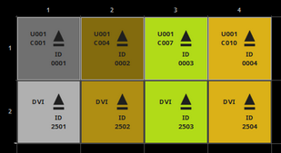

As listed above, you can choose to lock fixtures or unlock them again. Select one or more fixtures first and then use ▪Edit > Lock Selected Fixtures [Keyboard shortcut: Ctrl + K] or ▪Edit > Unlock Selected Fixtures [Keyboard shortcut: Ctrl + Shift + K]
▪DMX fixtures are shown in dark gray. Locked DMX fixtures are shown in dark orange. Selected DMX fixtures are shown in green. Selected but locked DMX fixtures are shown in orange. ▪DVI fixtures are shown in light gray. Locked DVI fixtures are shown in light orange. Selected DVI fixtures are shown in green. Selected but locked DVI fixtures are shown in orange.
▪The settings of a locked fixture cannot be edited.
•Locking affects the entire fixture, including its DMX channel in the DMX Map View or its DVI Map in the DVI Map View. •Locked fixtures cannot be moved, re-positioned, or removed. Drag & drop is also not possible. •Locked fixtures can be copied. Their locked state will not be applied and copied fixtures will therefore be unlocked.

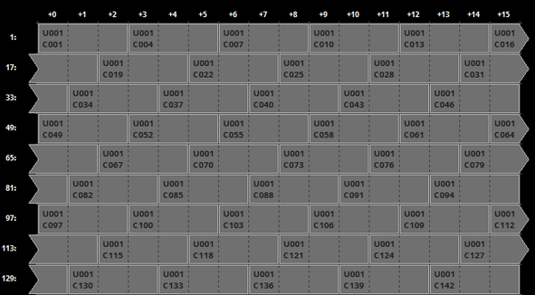

The DMX Map is one of three view modes that are available for the Patch Editor. ▪Voxel Map - Is the default view mode in order to work with the Patch Editor and the Patch. ▪DVI Map - Is only relevant when working with DVI fixtures. Learn more »DVI Patch ▪DMX Map - Allows you to view the Patch with regards to occupied and used DMX channels.
▪To display DMX Channel mode, click DMX Map
▪The DMX Map:
▪In order to work in a specific DMX universe, select the particular DMX Universe first.
