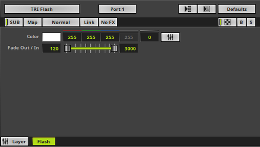

TRI Flash flashes the LED matrix when triggered by you.
Effect Options
▪This MADRIX Effects supports Effect Options for advanced workflows.
Learn more »Effect Options
Port Settings
Port - Selects the Trigger Port [1 - 64].
- Make sure to select the correct port first.
- This setting should correspond to the settings you have made in the Device Manager. Learn more »Configuration Of TRI
▪Various buttons and controls have universal functions. They are available for each MADRIX 5 Effect / Layer.
▪Color - Defines the color. The default color is White.
▪Fade Out / In - Defines the fade-in speed as well as the fade-out speed. The default values are 120 and 3000. Valid values range from 1 to 3000.
