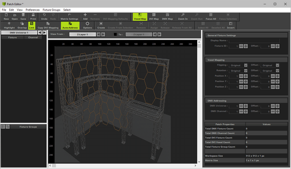

In order to help you with the placement of fixtures for your Patch, you may load a background image. As such, this is a feature of the MADRIX 5 Patch Editor. Learn more »Patch Editor
While the Patch Editor allows you to semi-automatically place fixtures according to your requirements, loading an image into its background can assist you with the manual placement of fixtures.

Example
In the Patch Editor, choose to View > Voxel Map / DVI Map / DMX Map in order to close the Background Image View again.
