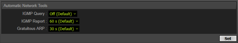

Automatic Network Tools
IGMP Query
Sends queries of the Internet Group Management Protocol to hosts in order to renew the membership in the multicast group, with regards to the controller being an sACN sender.
▪Valid settings include Off (Default), 30s, 60s, 2 min, 5 min, 10 min.
▪The default setting is Off.
IGMP Report
Sends reports of the Internet Group Management Protocol in order to maintain the membership in the multicast group, with regards to the controller being an sACN receiver.
▪Valid settings include Off, 30s, 60s (Default), 2 min, 5 min, 10 min.
▪The default setting is 60 Seconds.
Gratuitous ARP
Sends an Gratuitous ARP to make sure that the Ethernet connection is kept alive.
The operation code is 2 and target address is a normal MAC broadcast.
An ARP Announcement packet is also sent immediately in case the network connection has been established successfully.
▪Valid settings include Off, 30s (Default), 60s, 2 min, 5 min, 10 min.
▪The default setting is 30 Seconds.
