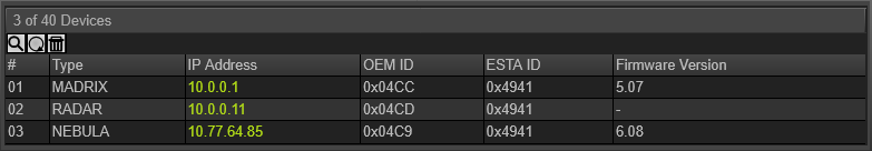

List Of Available Art-Net Devices
MADRIX AURA uses standard mechanics of the Art-Net protocol to find available Art-Net devices in the network.
The list is updated each second for 3 times after calling up the site or after clicking Search.
2 Of 40
[X Available Of A Maximum Of 40]
Shows the number of Art-Net devices that have been found and the maximum number that can be found.
Search - Searches for Art-Net devices in the network. [Please allow a few seconds for devices to appear in the list.]
Refresh - Updates the list to see if additional devices have been found since the last automatic update.
Remove - Removes all Art-Net devices from the list.
An index number of the Art-Net devices is provided for easier referencing.

IP Address
Shows the IP address of the Art-Net device.
When shown in green, it can be used as a click-able link to call up the Art-Net device with this IP address in the web browser.
OEM ID
Shows the OEM ID the Art-Net device has reported.
ESTA ID
Shows the ESTA ID the Art-Net device has reported.
Firmware Version
Shows the firmware version of the Art-Net device, if available.
