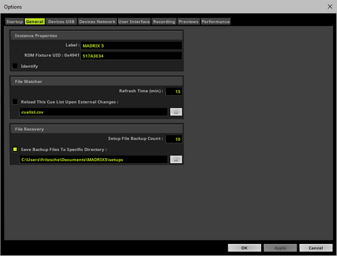

Go to the menu Preferences > Options... > General
[Keyboard shortcut: Ctrl+Alt+O > General]
File Watcher
Set up the options as explained below.
File Watcher
MADRIX 5 can automatically and regularly reload a Cue List within a pre-defined refresh time.
Activate Reload This Cue List Upon External Changes
Select the Cue List file via the button ...
Enter the Refresh Time (min) in minutes.

File Recovery
MADRIX 5 can automatically create a backup copy of your MADRIX 5 Setup file whenever you choose to save your Setup file. That means, before the new Setup file is saved, the previous state will be stored as a backup. [Should the saving process fail, you can access your Setup file again in the state it was saved last.]
Setup File Backup Count - Sets the maximum number of backup files that are created. The default value is 10. [MADRIX 5 creates separate copies to minimize the chance that a valid backup is overwritten by an invalid Setup file.]
Save Backup Files To Specific Directory - Enable this option if you want to set up a specific directory where the backup files should be stored. This can be external drives. If this option is disabled, MADRIX 5 will save the backups in the same directory as the Setup files.
- Choose the directory via the button ...
- By default, MADRIX 5 automatically chooses a user directory for Setup files.
MADRIX 5 will save a backup in the following way:
Filename_Date_Time.msz.msbackup
In order to restore a Setup file, remove .msbackup from the file name. The restored Setup file should then have a name, such as Filename_Date_Time.msz
