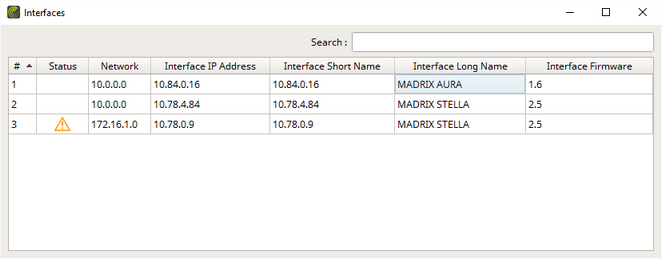

Represents the device numbering as index and is especially useful for referencing interfaces in the list or seeing the total number of found interfaces.
Status
May show icons if problems are detected.
In addition, a tooltip with specific information is provided [via mouse-over].
Warnings may include, for example:
▪The connection to this interface has been lost [A red X icon.]
▪The interface is not capable of transmitting RDM data, or RDM is currently disabled [An orange warning triangle.]
Shows the network IP address of the network adapter, to which the interface is connected. [TCP/IPv4] [This information refers to »Art-Net.]
Network Name
Shows the name of the network adapter.
Interface IP Address
Shows the IP address of the hardware interface. [This information refers to »Art-Net.]
Interface Short Name
Shows the short name of the hardware interface. [This information refers to »Art-Net.]
Interface Long Name
Shows the long name of the hardware interface. [This information refers to »Art-Net.]
Interface Firmware
Shows the current firmware version of the hardware interface. [This information refers to »Art-Net.]
Open Interface Configuration Via HTTP...
Opens a new web-browser window using the IP address of the interface in order to access the web configuration of the device. The interface needs to support this feature.

Interfaces Ignore List
Manually deleting interfaces will also remove them from the database. In addition, they will be added to an ignore list, which is managed internally by the software.
Thus, the software will no longer send requests to such an interface [since faulty RDM communication of such an interface can produce faulty entries in the software, which you might want to prevent].
This internal ignore list will persist across software restarts.
However, this ignore list will be cleared, and devices will be deleted from the list again, once you manually send out poll requests to discover all devices in the network via menu Devices > Discover Devices
