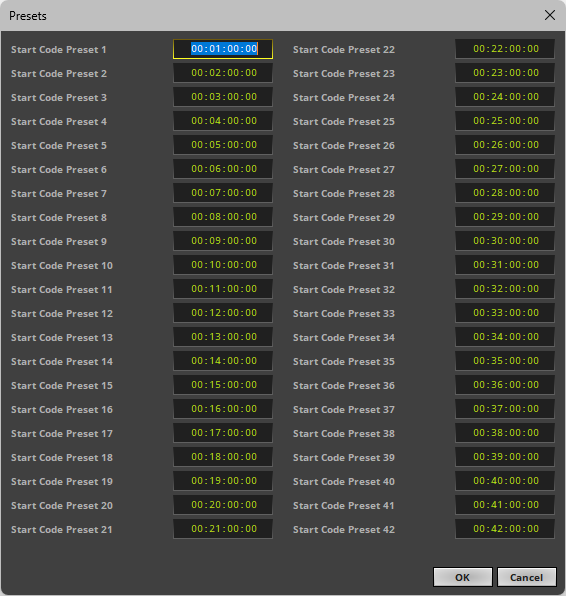

Presets - You can use 42 presets to quickly set up and utilize individual Start Codes.
▪[Keyboard shortcut: 0 – 9; in case no settings are currently selected.]
Preset Configuration - Use the configuration button to set up the Start Code presets.
