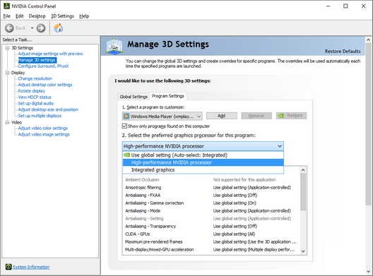

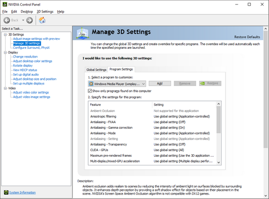

NVIDIA
If the default graphics processor is set to the integrated graphics card, you should select your high-performance graphics card as the default option. The step-by-step instructions below refer to drivers for NVIDIA graphics cards.
▪In Windows 11, go to Desktop > Right Mouse Click > NVIDIA Control Panel > 3D Settings > Manage 3D settings > Program Settings > 1. Select a program to customize > Add > Choose MADRIX 5 > Click Add Select Program > 2. Select the preferred graphics processor for this program: > Choose High-performance processor > Click Apply

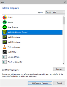

▪1] In Windows 11, go to Start [Windows Logo] > Settings > System > Display > Graphics
▪2] Add an app > Desktop app
▪3] Click Browse and navigate to the installation directory. By default C:\Program Files\MADRIX5
▪4] Select MADRIX.exe and confirm with Add
▪5] Select MADRIX 5 from the list and click Options
▪6] Choose High performance in Graphics preference and confirm with Save

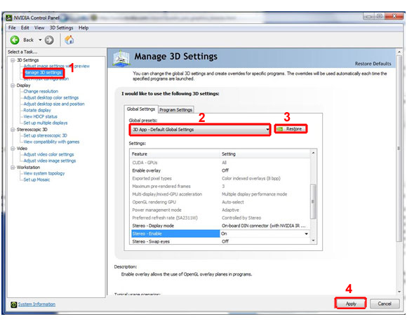

Using NVIDIA Workstation Graphics Cards
When using an NVIDIA Quadro/RTX AXXXX graphics card, please set up the following settings:
▪In Windows 11, go to Desktop > Right Mouse Click > NVIDIA Control Panel > 3D Settings > Manage 3D settings > Global Settings > Global presets: > Choose Workstation App - Dynamic Streaming > Click Restore > Click Apply
MADRIX 5 will show a message to you on the first start should you not have activated the preset yet.
