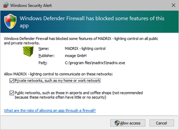

The primary purpose for the Windows Firewall [or any other firewall] is to block any unwanted incoming data and access. But this can lead to problems, when data that should go through is automatically blocked.
MADRIX 5 will automatically set the correct firewall settings for you during the installation process.
Please follow the steps below if this Windows message appears when you start the MADRIX 5 Software for the first time.
Windows Firewall Message
Set the checkmark for
Public networks
Private networks
Domain networks
Click Allow to confirm.
Not selecting all options is likely to cause problems with network communication.

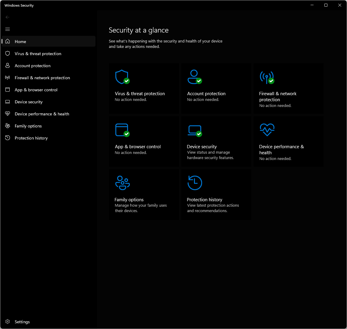

Resetting The Settings
If you have already chosen the wrong options MADRIX 5, you can delete the settings and choose again.

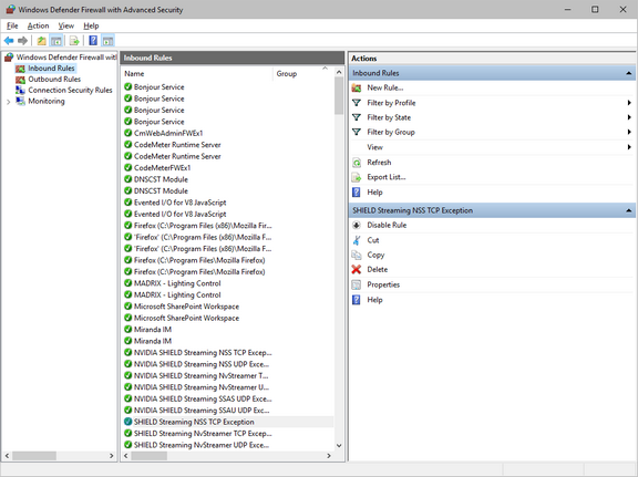

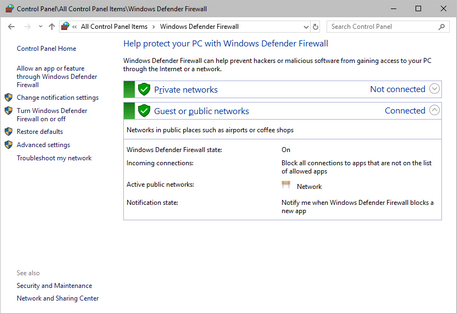

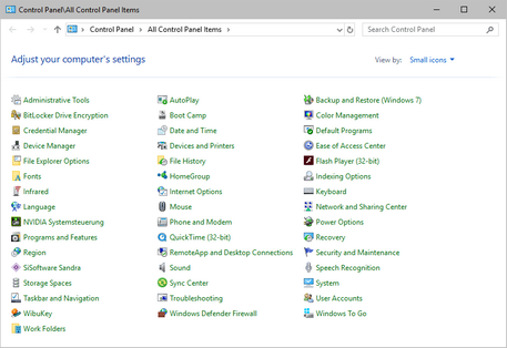

In Windows 10, go to Start > Windows System > Control Panel > Windows Defender Firewall > Advanced settings > Inbound Rules
In Windows 11, go to Start > Settings > Privacy & security > Windows Security > Open Windows Security > Firewall & network protection > Advanced settings > Inbound Rules
Select and delete any entries relating to MADRIX 5 [e.g., madrix.exe, MADRIX - music makes the light, MADRIX - LIGHTING CONTROL].
With your next start of MADRIX 5, select both options as described above.

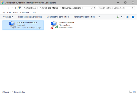

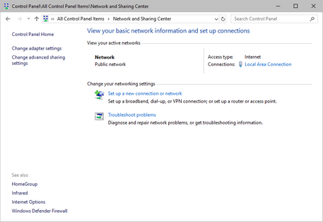

In Windows 10, go to Start > Windows System > Control Panel > Network and Sharing Center > Change adapter settings > Local Area Connection > Properties > Internet Protocol Version 4 (TCP/IPv4) > Properties
In Windows 11, go to Start > Control Panel > Network and Internet > Network and Sharing Center > Change adapter settings > Ethernet > Right-Mouse Click > Properties > Internet Protocol Version 4 (TCP/IPv4) > Properties

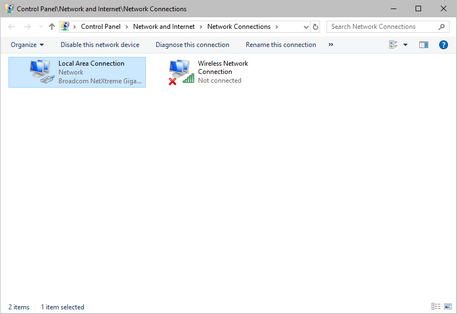

1] In Windows 10, go to Start > Windows System > Control Panel > Network and Sharing Center > Change adapter settings
2] Press Alt on your keyboard.
- A menu appears at the top, which is otherwise hidden.
3] Go to Advanced > Advanced Settings...
- A new window opens.
4] Select your preferred network connection[s] in the list of Connections:
5] Change the order by clicking on the green up and down arrow buttons on the right hand side.
- The connection which is listed on top, is the first and prioritized adapter.
6] Click OK to confirm.
