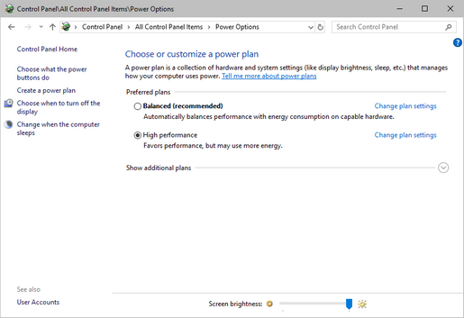

Especially for notebooks, we recommend to activate the High performance power plan.
Activate High Performance
This setting will make sure that your notebook or laptop will have all its potential performance available for MADRIX 5.
In Windows 10, select Start > Windows System > Control Panel > Power Options, and change the power plan to High performance
[You might need to click on Show additional plans].
In Windows 11, select Start > Settings > System > Power & battery > Power > Power Mode and change the power plan to Best performance

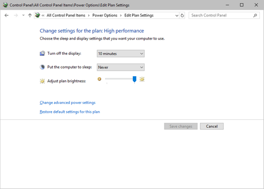

How To Change USB Power Settings
In Windows 10, select Start > Windows System > Control Panel > Power Options > Change plan settings
In Windows 11, select Start > Control Panel > Hardware and Sound > Power Options > Edit power plan
Click Change advanced power settings

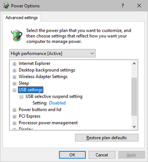

Change Advance User Settings
Especially the USB settings are important. Disable the suspend settings!
Disable Energy Saving Options
Change any other settings that might interrupt the operation as required.
