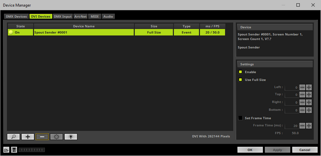

3] Activating The DVI Device
Go to the menu Preferences > Device Manager... > DVI Devices
[Keyboard shortcut: F4 > DVI Devices]
DVI Devices Tab
Add devices manually.
- Click
- A small selection list will be opened above the button.
Add New DVI Device
- Select Spout
The new DVI device will appear in the list after is has been added.
There are different Settings available for further configuration. By default, all settings should be set up correctly already.
If you change a setting, always click Apply to confirm the changes.
Enable - Activates or deactivates the currently selected DVI device. This is activated by default. It needs to be activated in order to work correctly.
Use Full Size - Displays the full Matrix Size on the device. This is activated by default and the recommended setting.
- Deactivate if you want to set up a certain cut-out and specify which details of your matrix will be shown. You can choose the start coordinates and the end coordinates of this area. Left and Top define the start coordinates in a coordinate system that starts with 0,0 in the top left corner. Right and Bottom define the end coordinates.
Scaling is not available.
Your virtual LED matrix will not be stretched or compressed in order to fit the DVI device or vice versa.
Set Frame Time - Activate in order to set a different frame time in milliseconds. By default, the DVI device is set to be an Event type with the software's main mixing frame rate [50 FPS by default] .
- If you manually set a new frame time, the output might judder.
- It is not recommended to set a higher frame rate than 50 FPS. But if your hardware controller requires a different, adjust the value to these requirements. Then, the type of your device will be set to Frame in the list.
- Removes the currently selected DVI devices.
Highlight Device Button - Makes your device flash and will set all pixels instantly to white for testing purposes.

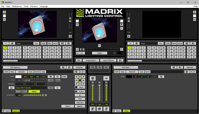

In order to receive Spout, you need to use the MADRIX Effect SCE Capture
1] Prerequisites.
2] Using SCE Capture.
1] Prerequisites
Make sure your are sending Spout.
Select SCE Capture from the library of effects.
Learn more »Effects [Visuals]

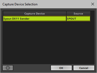

- Open a device.
Select your Spout sender from the list.
- The Source is Spout
MADRIX 5 will now receive Spout.
Learn more »SCE Capture
