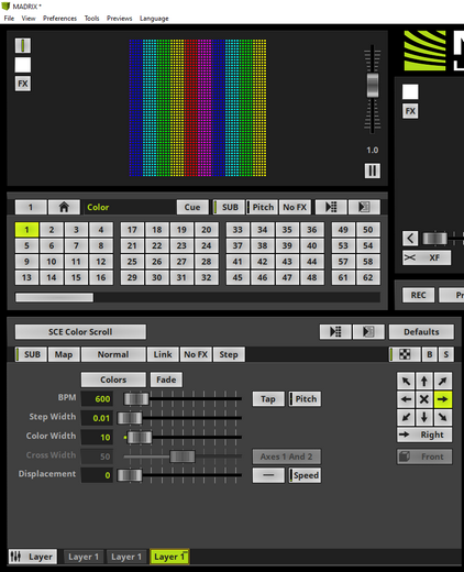

In the first step we will copy the Effect Layer called Layer 1 of the activated Storage Place. To copy an Effect Layer please perform a right click at the desired Effect Layer and select Copy in the context menu.

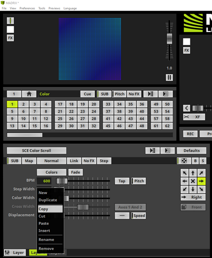

Now we will insert it as a new Effect Layer between Layer 1 and Layer 2. Therefor we select the Effect Layer called Layer 1, perform a right click and choose Insert in the context menu.

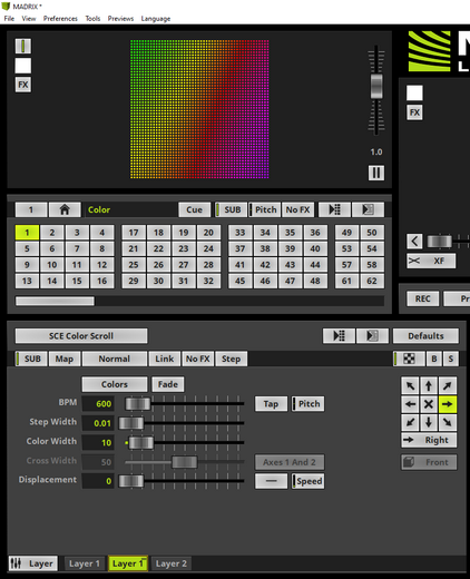

Insert will add a new Effect Layer with the content of the copied Effect Layer. The inserted Effect Layer will always be added at the right side of the selected Effect Layer and will be selected automatically.

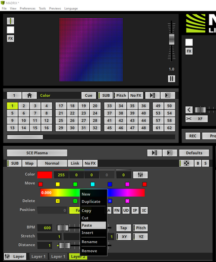

In this step we will overwrite the settings of Effect Layer called Layer 2 with the settings of Layer 1. The settings of Layer 1 are already copied and we can overwrite it by pasting the settings at Layer 2.
To paste the settings we select Layer 2, perform a right click at Layer 2 and select Paste.
![](04_copypaste.png)

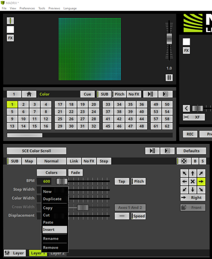

Paste will overwrite the current Effect Layer settings with the settings of the copied Effect Layer.
