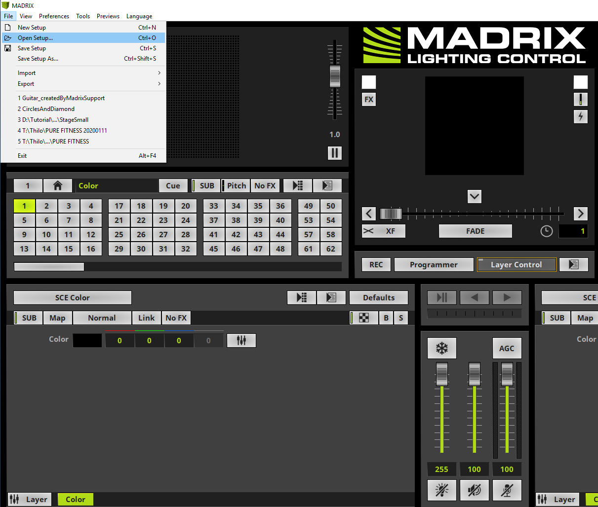

In the next step please start MADRIX 5 and open the downloaded MADRIX setup. To load the setup please go to File > Open Setup and navigate to the path where the MADRIX setup is saved. In this example it is the folder where you unzipped the downloaded file.
Now MADRIX 5 loads the setup and the Open Setup Options appears. Please enable all options and click OK.
