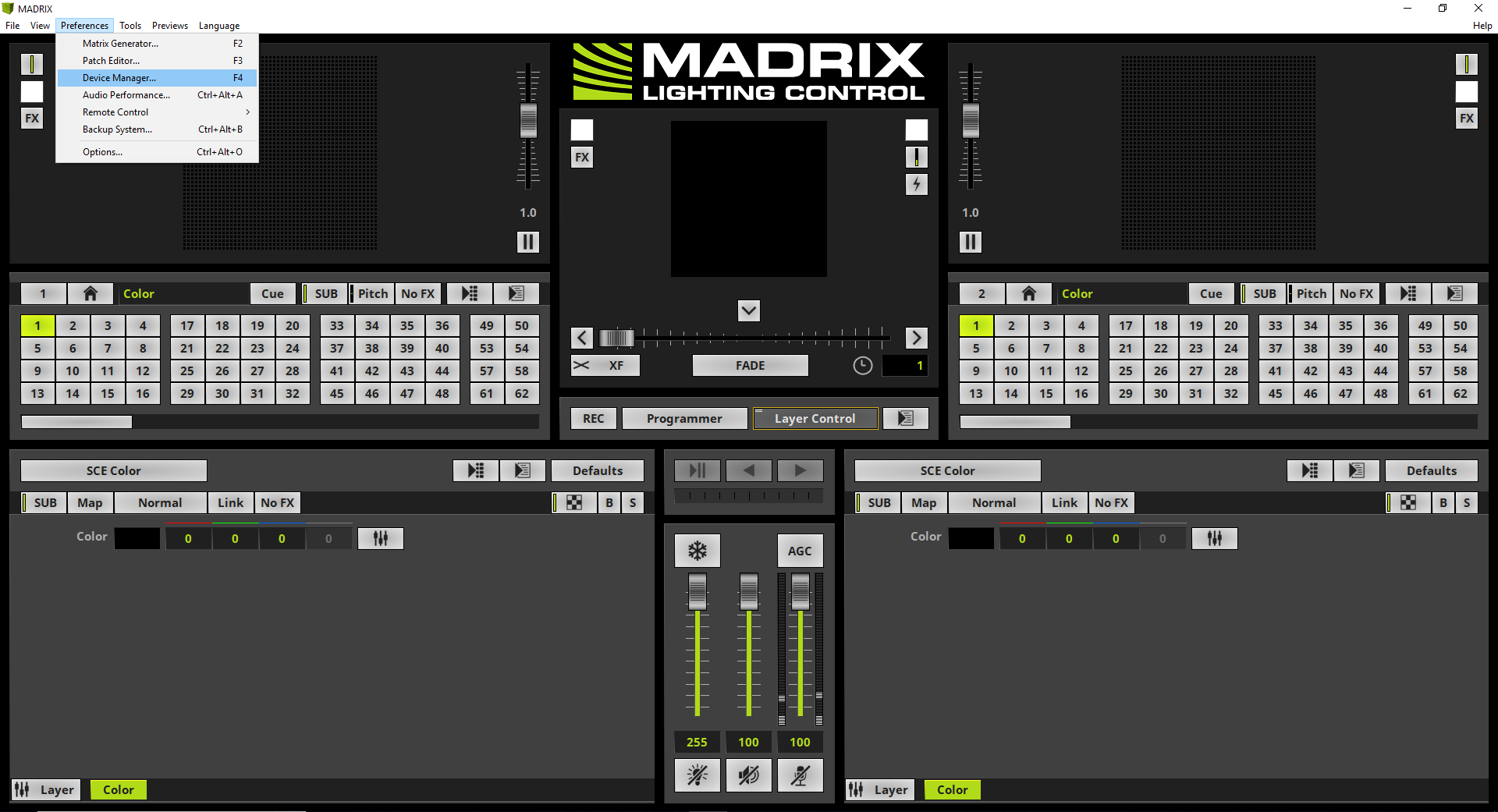

To configure a proprietary DVI protocol in MADRIX 5 please start the Device Manager. To open the Device Manager please go to Preferences > Device Manager.
[Keyboard shortcut F4].
![](01_t9.png)

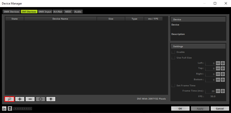

Now please go to the DVI Devices tab.
Below the Device List you will find the Search button. Please click this button and the search process will start.
![](02_t9.png)

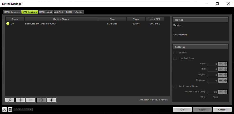

After the search process was finished we will find a EuroLite T9 Device in the Device List. Now we can click OK and MADRIX will send the information of the DVI patched Voxel to the T9 Device.
Note: MADRIX will starting to send the DVI data from the Front Top Left Voxel to the connected T9 Device. If you want to patch the T9 Device to another position, please create also a »DVI Map in the Patch Editor.
![](03_t9.png)
