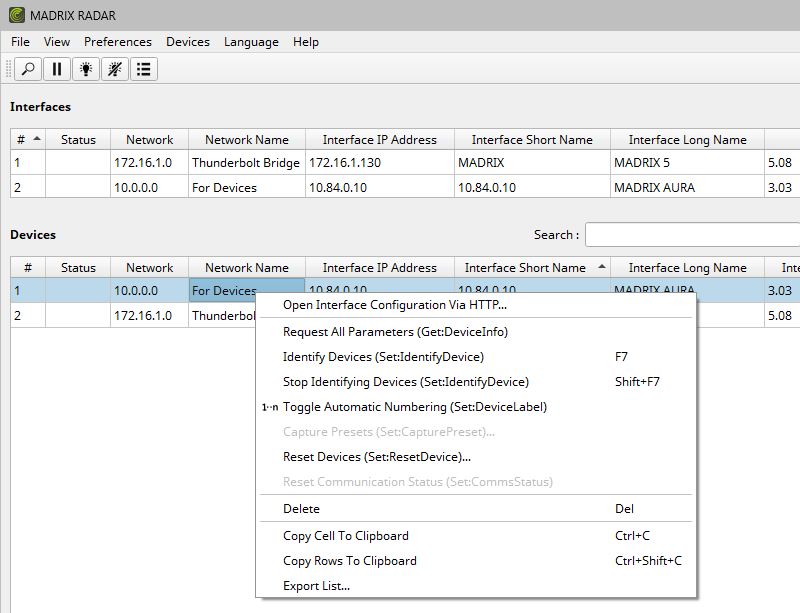

You can use software like MADRIX RADAR to use and monitor the RDM functionality.
Interfaces
You can restart the device [Reboot System] over RDM via RDM command RESET_DEVICE.
▪In MADRIX RADAR, select your unit from the list of Devices and perform a right-mouse click > Reset Devices (Set:ResetDevice)...
▪0x01 - WarmStart and 0xFF - ColdStart will reboot the system.

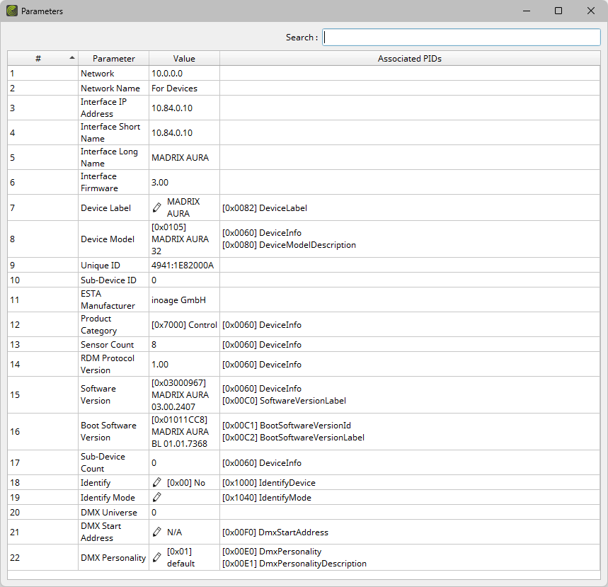

Parameters

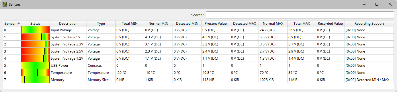

Sensors
