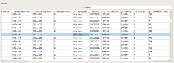

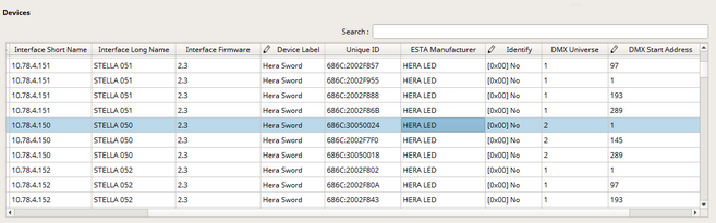

The list of devices is the main view of the software.
It shows all found RDM devices [that is, luminaires and lighting fixtures for example] and their respective settings, parameters, and characteristics.
This also includes the hardware interfaces to which they are connected.
Represents the device numbering as index and is especially useful for referencing devices in the list or seeing the total number of found RDM devices.

Device Label
Can be edited. Shows the currently set name or description of the RDM device.
Unique ID
Represents a unique identifier of the RDM device. It is shown as HEX [without 0x] and using a colon [:] as separator. The first part is the ESTA ID of the manufacturer and the second part is a number, which can be freely defined by the manufacturer.
ESTA Manufacturer
Shows the name of the manufacturer based on the list of manufacturers as published by ESTA. [It is retrieved from the first part of the RDM-device ID.]
Identify
Can be edited. Allows you to choose/activate the built-in identification mode of the RDM device. [It should also work for fixtures that haven't had their parameter scanned yet or may be able to listen but not be able to respond to requests.]
DMX Universe
Shows the currently assigned DMX universe for the RDM device. [Learn more »Glossary]
DMX Start Address
Can be edited. Shows the currently set DMX start address of the RDM device. [Learn more »Glossary]
DMX Personality
Can be edited. Shows the currently set DMX personality of the RDM device. This can also be referred to as operation mode of the RDM device.

▪Search - Enter any text in order to search all devices in the list.
- For example: Interf:MAD shows all lines where a MADRIX hardware interface is connected by referencing the column Interface Long Name/Interface Short Name, for example. If no column is shown that includes 'Interf', MADRIX RADAR will search all shown columns for the specifically entered term.
