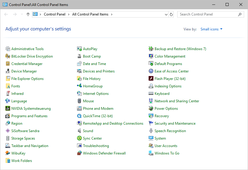

▪In Windows 10, go to Start > Windows System > Control Panel > Windows Defender Firewall > Advanced settings > Inbound Rules

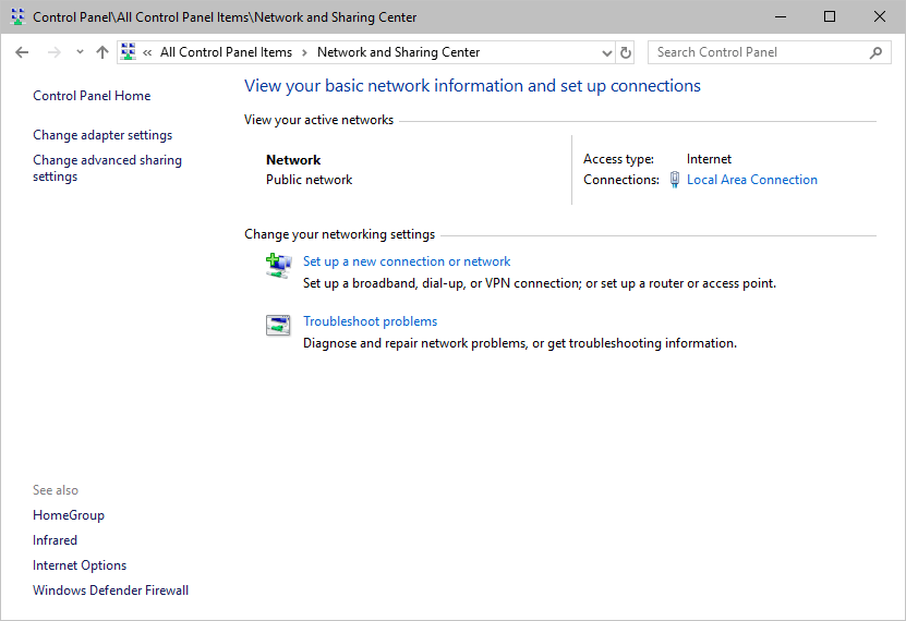

When working with network-based products and MADRIX 5 [for example, Art-Net, KiNET, sACN, etc.], you will have to set up the IP address of your network card in Windows. Learn how to set it up here.
▪In Windows 10, go to Start > Windows System > Control Panel > Network and Sharing Center > Change adapter settings > Local Area Connection > Properties > Internet Protocol Version 4 (TCP/IPv4) > Properties

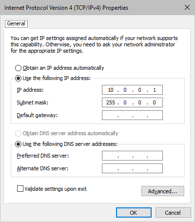

Set up the following settings:
▪Enable Use the following IP address:
▪IP address - Sets the IP address for this computer and this network card.
- If you have several network cars in your computer, you can set up an individual address for each network card.
- An IP address has 4 parts. Enter the complete address as explained in the specific chapter of this user guide [e.g., 10.0.0.1].
- You only have to enter the numbers.
▪Subnet mask - Sets up the Subnet mask for this computer.
- This is an important part of the network settings, just as the IP address.
- A Subnet mask has 4 parts. Enter the complete address as explained in the specific chapter of this user guide [e.g., 255.0.0.0].
▪OK - Click to save your settings.

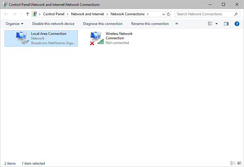

▪1] In Windows 10, go to Start > Windows System > Control Panel > Network and Sharing Center > Change adapter settings
▪2] Press Alt on your keyboard.
- A menu appears at the top, which is otherwise hidden.

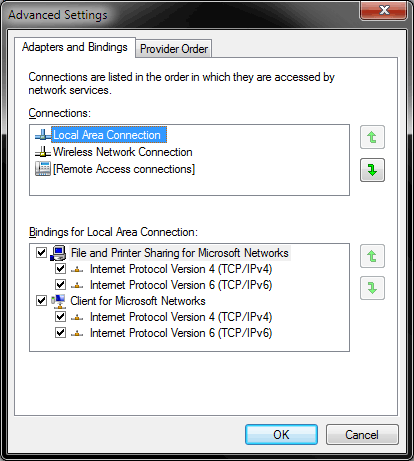

▪3] Go to Advanced > Advanced Settings...
- A new window opens.
▪4] Select your preferred network connection[s] in the list of Connections:
▪5] Change the order by clicking on the green up and down arrow buttons on the right hand side.
- The connection which is listed on top, is the first and prioritized adapter.
▪6] Click OK to confirm.
▪7] Restart your computer.
