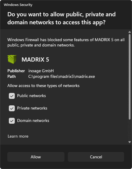

Please follow the steps below if this Windows operating system's message appears when you start the MADRIX 5 Software for the first time.
Set the checkmark for
▪Public networks
▪Private networks
▪Domain networks
▪Click Allow to confirm.
Not selecting all options is likely to cause problems with network communication.

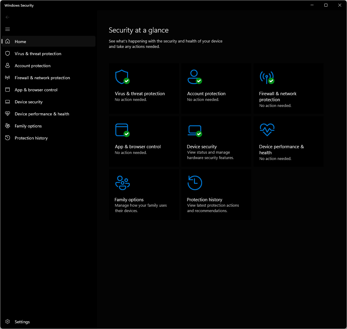

Resetting The Settings
If you have already chosen the wrong options MADRIX 5, you can delete the settings and choose again.
▪In Windows 11, go to Start [Windows Logo] > Settings > Privacy & security > Windows Security > Open Windows Security > Firewall & network protection > Advanced settings > Inbound Rules
▪Select and delete any entries relating to MADRIX 5 [e.g., madrix.exe, MADRIX - music makes the light, MADRIX - LIGHTING CONTROL].
▪With your next start of MADRIX 5, select both options as described above.
