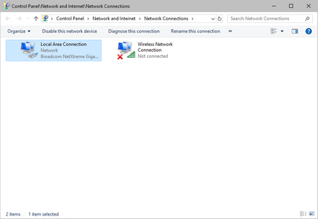

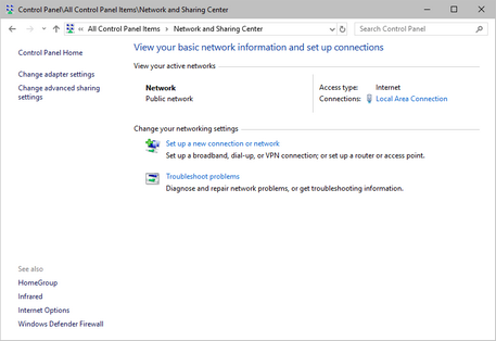

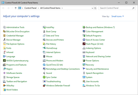

Configuration Of Network Settings When working with network-based products and MADRIX RADAR [that is, Art-Net], you will have to set up the IP address of your network card in Windows. Learn how to set it up here. ▪In Windows 10, go to Start > Windows System > Control Panel > Network and Sharing Center > Change adapter settings > Local Area Connection > Properties > Internet Protocol Version 4 (TCP/IPv4) > Properties Set up the following settings: ▪Enable Use the following IP address: ▪IP address - Sets the IP address for this computer and this network card. ▪Subnet mask - Sets up the Subnet mask for this computer. ▪OK - Click to save your settings. ▪Restart the MADRIX RADAR Software if you have changed any network settings! Learn more below.

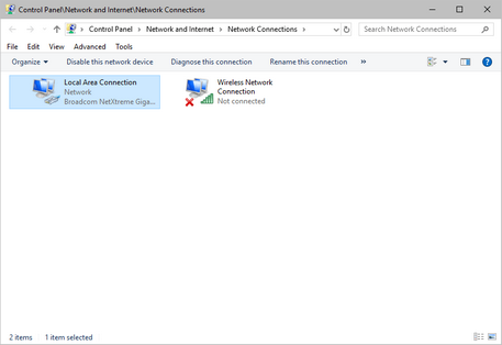

Changing The Priority Of Network Adapters You can change the order in which Windows and MADRIX RADAR accesses your network adapters. By changing the order, you can specify which network adapter [network card] is used first and as the main connection. ▪1] ▪2] Press Alt on your keyboard. ▪3] Go to Advanced > Advanced Settings... ▪4] Select your preferred network connection[s] in the list of Connections: ▪5] Change the order by clicking on the green up and down arrow buttons on the right hand side. ▪6] Click OK to confirm. ▪7] Restart your computer.

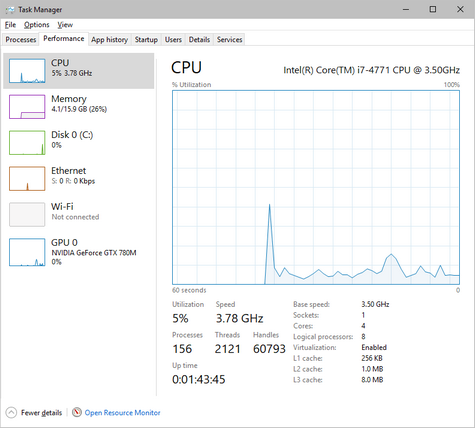

Monitoring Computer Performance Windows allows you to monitor the overall performance of your computer. ▪Press Ctrl + Alt + Del and choose Start Task Manager ▪A new window opens [Task Manager]. ▪Go to Performance
▪You can now monitor the CPU Usage as well as the Memory usage.
