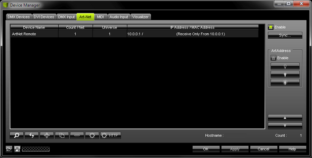

In MADRIX, navigate to the menu 'Preferences' > 'Device Manager...' (or press 'F4'). Select the tab 'Art-Net'.
Enable Art-Net here by activating the check-box in the upper right corner ('Enable').
If you have enabled Art-Net inside this dialog, you will see at least one entry. The 'ArtNet Remote' entry is automatically provided by MADRIX and you can use it for controlling MADRIX remotely within the Art-Net network (Art-Net Remote).
MADRIX supports only one 'ArtNet Remote' device (with up to 4 ports/universes).
Device Manager - Art-Net

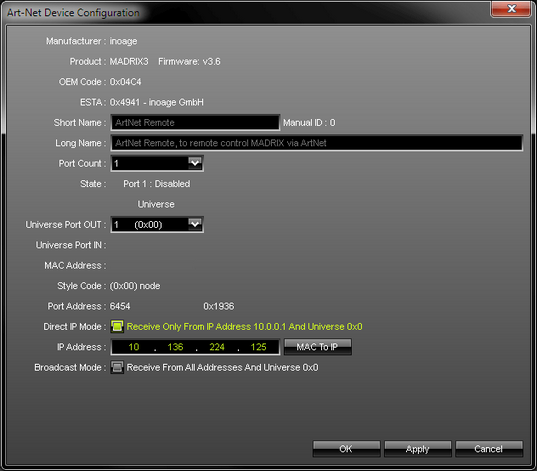

Select 'ArtNet Remote' in the list and click and you can modify the DMX universe and other options.
Device Configuration
If you activate 'Broadcast Mode', any light desk in the network can send data to MADRIX.
If the option 'Direct IP Mode' is enabled, only a lighting desk with the IP defined in the 'IP Address' input field can control MADRIX!
Please also configure 'Universe Port OUT'. This specifies which Art-Net Universe MADRIX is listening to. Please choose the universe on which your Art-Net device is sending the data.
Please confirm your settings with 'Apply'. Click 'OK' to close the window.
In the tab 'Art-Net', click 'Apply' after the configuration process.

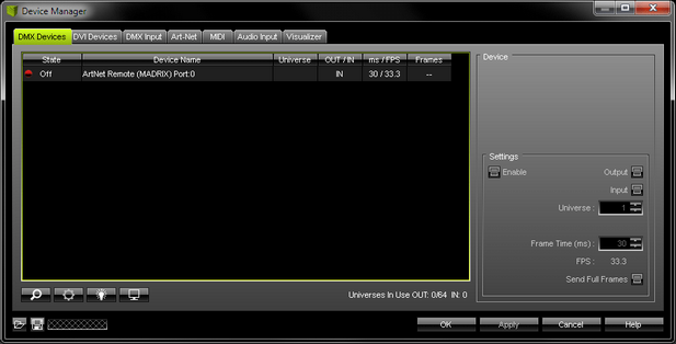

Now, go to the tab 'DMX Devices' in the 'Device Manager'.
DMX Devices

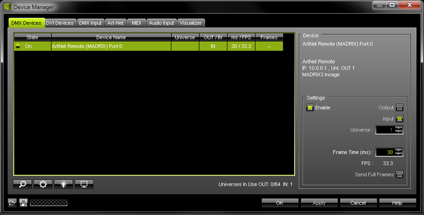

Select 'ArtNet Remote'. Then, activate 'Enable' and 'Input' in the section 'Settings'. Click 'Apply' afterwards.
Activating the Art-Net Device
Please check if 'Enable and 'Input' are activated!

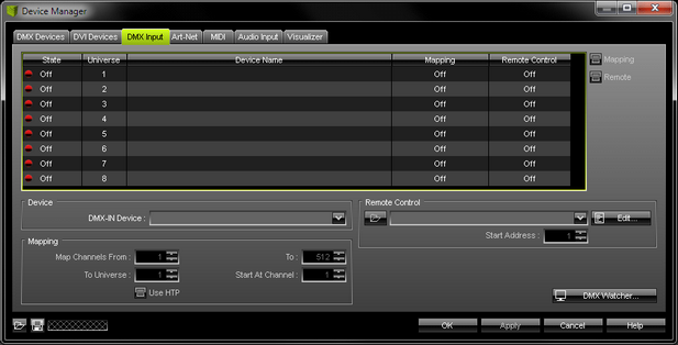

Now, go to the tab 'DMX Input' in the 'Device Manager'.
DMX Input Tab

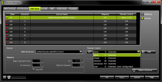

Choose an entry in the list ('Universe' 1 to 8).
Then, select your input device under 'DMX-IN Device'.
Afterwards, select your device in the list again and enable 'Remote' (in the upper right corner).
Now, choose one of the input protocols in the section 'Remote Control'. 6 pre-defined standard protocols are already implemented. Choose 'User' if you wish to create your individual remote configuration. For more information and the configurations of the 3 standard protocols, please see the MADRIX Help And Manual. You may also choose a protocol and click 'Edit...' to see the configurations.
DMX Input
Close the window with 'OK'.
